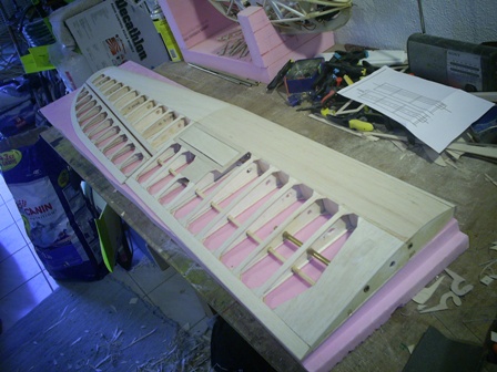

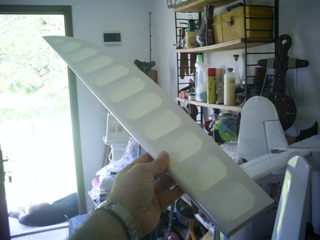

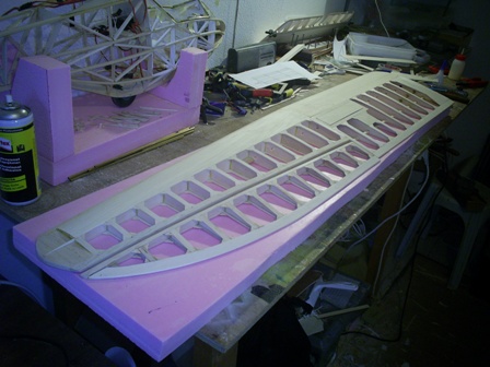

| Left wing & aileron..

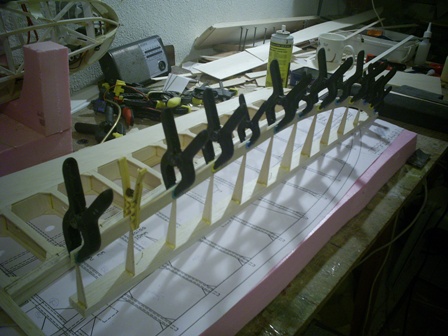

| Right aileron..

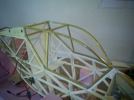

|  Posté le: 28/03/2009 15:17    Sujet du message: |     |

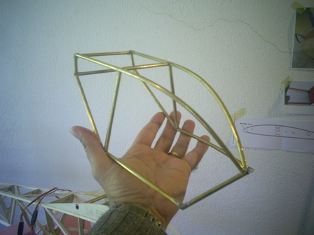

| Canopy..:

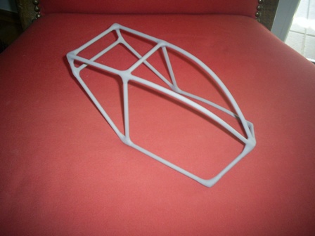

|  Posté le: 29/03/2009 17:18    Sujet du message: |     |

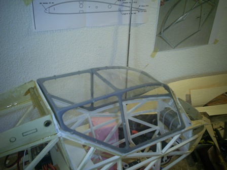

| After painting canopy frame.
| Revenir en haut de page |  |

|  Posté le: 30/03/2009 05:42    Sujet du message: |     |
| brilliant, is your canopy.......
 ( dixit ma Môman...)

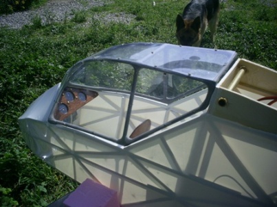

|  Posté le: 30/03/2009 17:57    Sujet du message: |     |

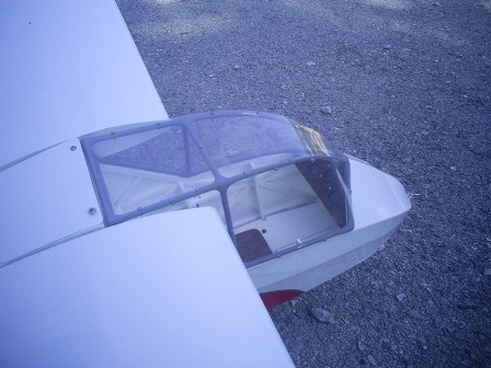

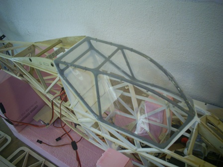

| New canopy pictures..
| VincentB Serial Posteur
 Âge: 61
|  Posté le: 30/03/2009 18:00    Sujet du message: |     |
| very good ![[good]](images/smiles/good.gif)  now, the more difficult is finish

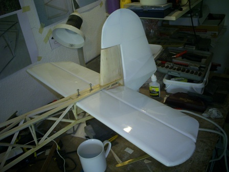

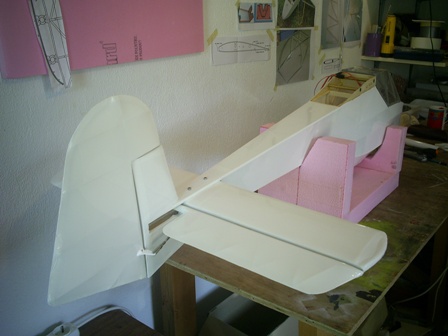

|  Posté le: 01/04/2009 16:58    Sujet du message: |     |

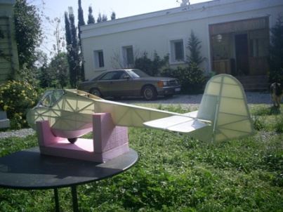

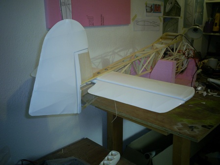

| Tail pictures..:
  Cem Zırh
 Fafnir

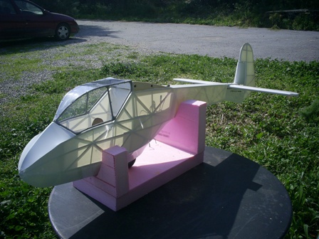

| Fuselage pictures.

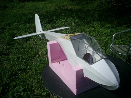

| More fuselage pictures....

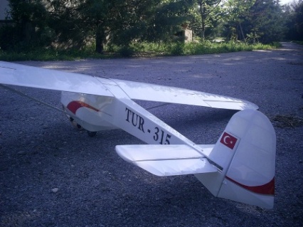

|  Posté le: 02/04/2009 19:57    Sujet du message: |     |
| I plan to make it simple. Main colour white, text gray ![[good]](images/smiles/good.gif)
  Cem Zırh

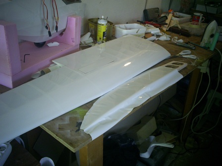

|  Posté le: 04/04/2009 15:09    Sujet du message: |     |

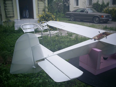

| Wings covering..
  Cem Zırh
 Fafnir
| czirh Accro Posteur
 Inscrit le: 21 Fév 2009
 Localisation: Bodrum, Turkey
 Âge: 62

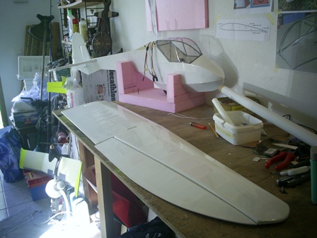

|  Posté le: 05/04/2009 17:52    Sujet du message: |     |
| White Doppi..
  Cem Zırh
 Fafnir

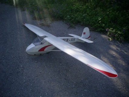

|  Posté le: 08/04/2009 16:12    Sujet du message: |     |

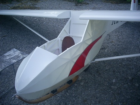

| My Doppi ... VOILA !!!

|  Posté le: 08/04/2009 16:30    Sujet du message: |     |
| very nice ![[clap]](images/smiles/Clap.gif) |  |

|  Posté le: 08/04/2009 16:38    Sujet du message: |     |
| ![[clap]](images/smiles/Clap.gif)  ![[clap]](images/smiles/Clap.gif) , beautiful and more speed that your schade

|  Posté le: 08/04/2009 17:57    Sujet du message: |     |
| Too much quik, unbelivable  ..... But very nice Congratulation

|  Posté le: 13/04/2009 07:10    Sujet du message: |     |
| Hi Cem, very nice, and original with Turkish flag   soon the first flight? make a serious check-list and wait the best wind
