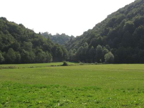

I plan to do it such way:
First "flight" or "jump" will be done in a plain level meadow, (very large without obstacles).
I will use bungee asisted launch. It is a short bungee that can pull 4 kilograms with average speed exceeding 30 km/h. (I test bungee "Mythbuster`s style"...test with 4 kg weight and recording with a camera to measure travel of each frame on the video..finding out a velocity)
At model side of bungee I will use about 50m of line, so if somehow line stay attached to the tow hook, model will be free to fly for about 100m in length. Just a safety percaution, and a way to avoid model to land just to the spike where a bungee is anchored to the ground.
A friend of mine, will hold a glider level and tension the bungee chord . Then he will make copule steps (about 10 steps rearward), holding model level make some fast steps forward and release it from hands. The bungee will accelerate model some 10 feets and model will be in the air. From those 2 meters of height it will glide until land.
I will probably make safe landing and then do all necessary corrections on the trim and controll throws.
Then will do some more short flights.
If everything went well, we will try start model from a little slope above this field (~5m high) and probably will be able do do some S or U flights until land.
And then.... the real slope or aerotowing on the nearest model airfield.

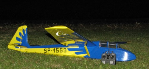

I am finished with work and now praying for a nice weather tomorrow. [oouf] [peur]
I set controll surfaces deflections:
Rudder: 30° left&right, 30 EXPO
Elevator: +/- 20°, 30 EXPO
Ailerons: down 10°/up 15°, 30 EXPO (frise type ailerons)
What do you think? It is my judgment, but I dont know if model will be lazy or too lively....

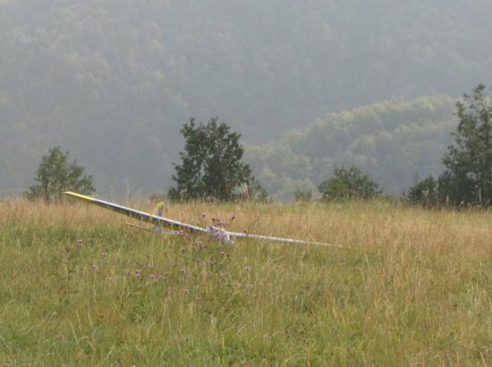

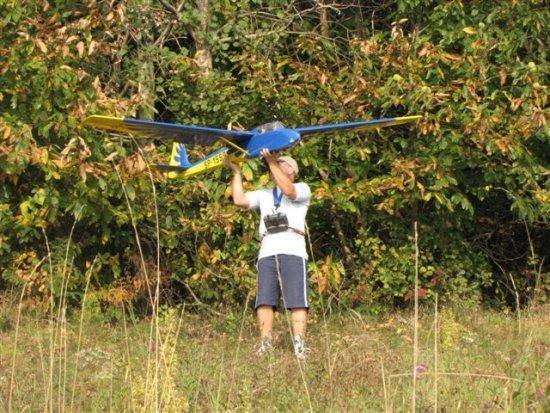

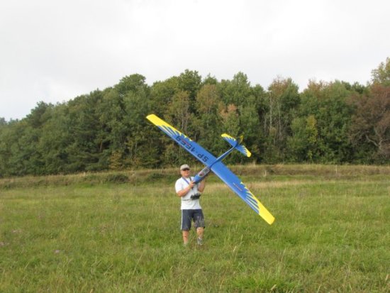

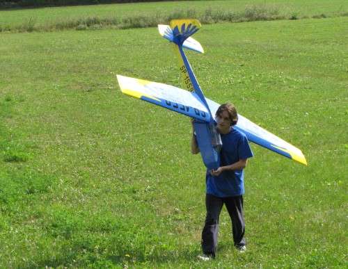

Today I made some short flights with a model. Very Happy
I need to add some nose weight and lower the controll throws, as model was lively and nervous when flying.
But awerall feeling about model is pretty well. I think, it will be a pleasant flyer after CG and deflections will be properly set.

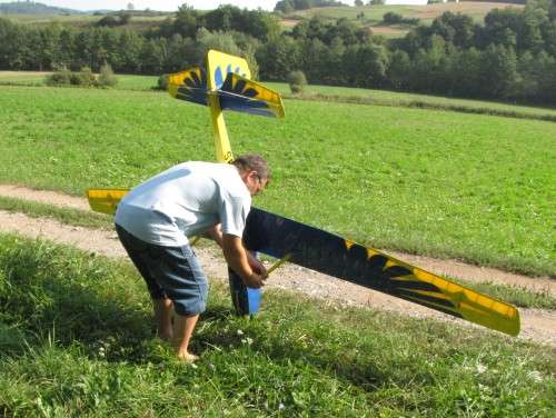

Here are some photos and a short video (click):

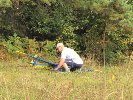

Model assembly on the field.
I use 40m of a thin chord and 6 bicycle inner tyres as a bungee chord, joined in length. It was about 20 steps of usable elasticy..just enough for a nice asisted launch of the model.
Next flights will be much easier now.
Regards!

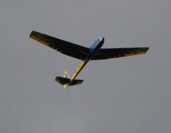

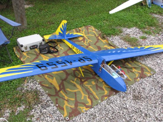

Today I was present on an aerotow meeting. A giant Piper towing plane take my Czapla to the heights!
I was very concerned before the actual towing as it was my first time. But they told me, it was just O.K. for a first timer. I jump a little to much up and down behind a tow plane but we manage to rise to decent altitude.
I trim a little to down and right and then enjoy the graceful slow flight of the sailplane. I think, I even made some turns in a brief thermall, but I was too concern of aquinting myself with model, and more concentrating to pure fligtr rather than centering a thermal. I was a little high at final, but I didn`t want to risk another 360° turn, so I open brakes, make some "S" approach and manage to land on the field.
Now I am more convinced about the plane and my ability to fly it, so next step is to fly on the slope, when apropriate wind will starts to blow.
But of course I will attend next gathering of aerotow enthusiasts in a month or so...

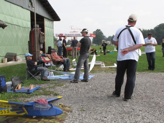

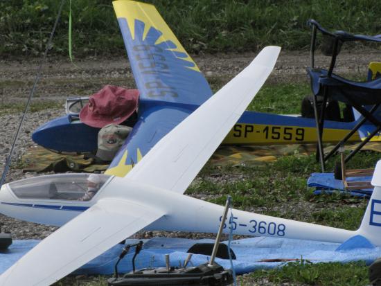

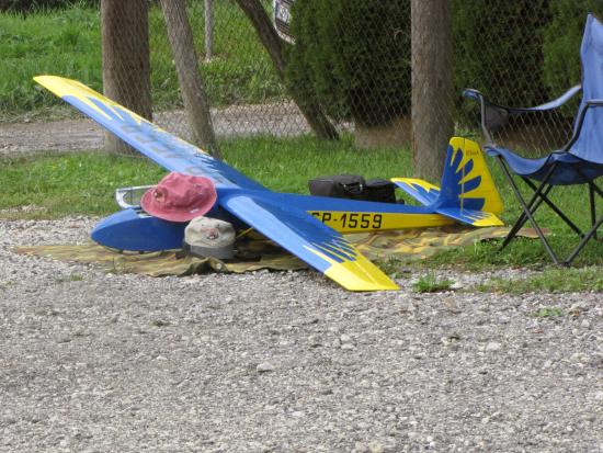

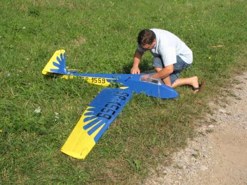

Some photos of today`s meeting:
Assembling the glider.
Group photo.
Parking....
Towplane, semiscale Piper Super Cub
My Czapla was only Vintage.. all others were glass ships...
Some of them really big and elegant....

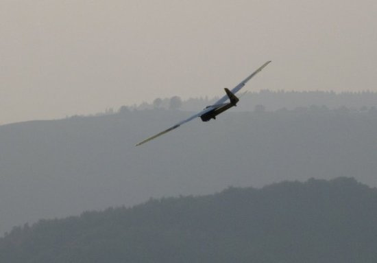

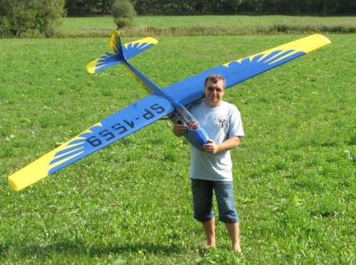

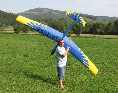

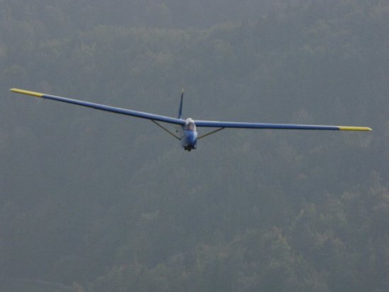

Today I made a first flight on the slope with Czapla!
It was even better than I imagine! Very Happy
I was amazed with agility and soaring capability! Model responds very prompt on the controls, but they should be very harmonized and coordinated. Strong use of rudder is needed when put in or out of a turn, but then Czapla can turn in very small radius (look at the video)
There were a little low wind and on moments it allso dissapear, but luckily some thermalls save me a couple of times. Model soars very nicely.
At some higher speed the voice that model produce sounds very "vintage" and it is awesome to hear it!
Here are some photos, and at the bottom you will find a link to teh short video of that flying.
Assembly of the model on the starting place.
Checking the model and waiting for a headwind.
Starting! Laughing What a figure?!
And a VIDEO (click)
