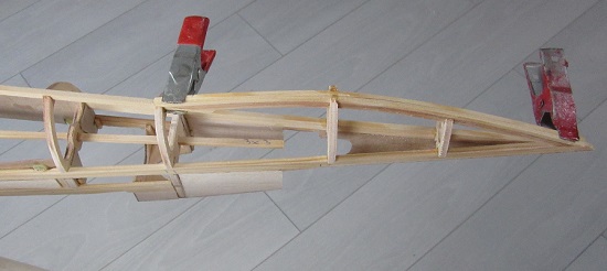

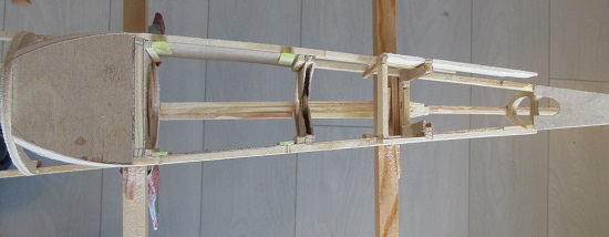

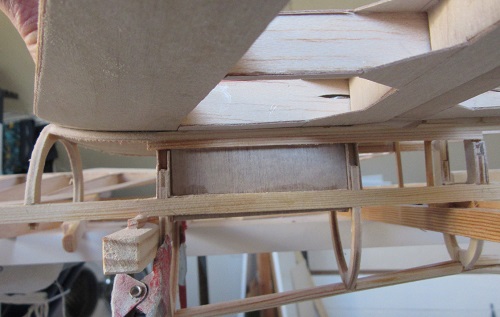

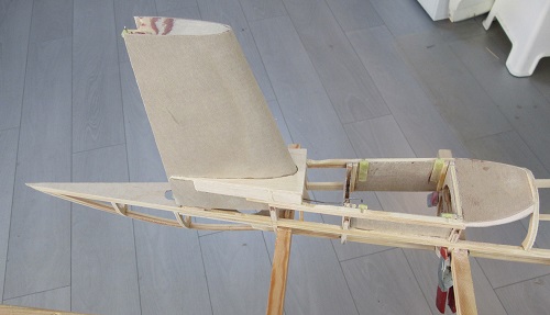

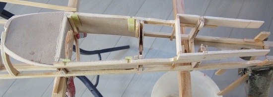

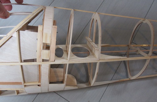

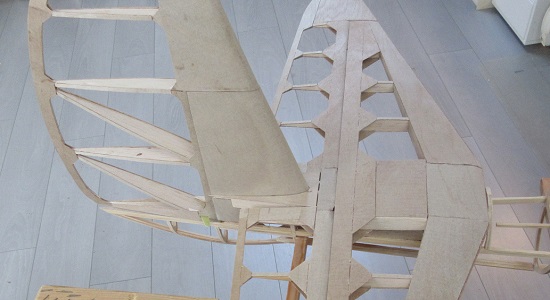

Sorting out the tail.

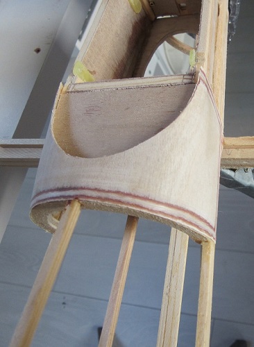

First I had to make the tail shoe, I laminated the bottom girder and made two small frames, I had to deduct that from the photos how that was constructed, nice to find out, but sometimes it takes a while!
 I could not find any details of the fuselage to the horizontal stabilizer transition in any photo. I think the mounting method would be just like the Gull I built before and which was made by the same people. It was stuck with 4 horizontal pins that were inserted from both sides
 this gives an idea of how that was made in the real Gull.. In the model of my Gull I solved that with 2 continuous 1mm steel wire pins and that is how I want to do it for the King Kite. The design of the fuselage at that location was not clear to me.
 First I made the frames at the stabilo position according to the drawing. Partly because I did not know the thickness of the stabilizer profile, this was not correct. so it did not work, I adjusted it in 3 different ways before I felt that I had it right. For the fairing of the fuselage at the front of the horizontal stabiler I laminated a plate
 from balsa and 0.4mm plywood on both sides, which I sanded in a in contour of the fuselage. It turned out that there was also kind of infill in front of the vertical fin
 Unfortunately, I had made the vertical fin a bit thinner than the real one, so that now the elevator no longer fitted nicely to it, I also changed that a bit. So, after gluing the vertical fin and properly positioning the stabilo
 , I thought that , when sheeted with ply, it will look just as the real thing.
Vincent (DB) |

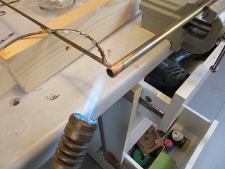

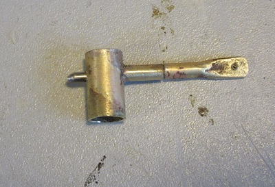

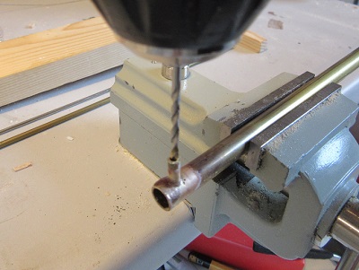

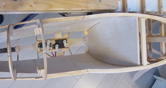

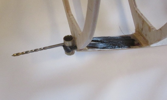

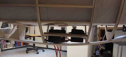

The placement of the servos was next. Before I started, I first made a tow coupling. On the Gull I had made one that worked well and took up little space inside. I soldered a piece of 6mm internal brass tube and another piece of 2mm internal brass pipe at right angles to each other with silver.
 Drilled a 2mm hole through and through and made it a bit larger with a reamer .
 so that a 2mm iron round could move freely through it. Over that 2mm round I soldered a piece of brass tube, which I flattened at the end with a hammer and drilled a 1mm hole for the operating rod
 I glued the coupling in the front fuselage frame, reinforced it with some roving to take up the forces
 (the 2mm drill is only temporary while the resin sets)

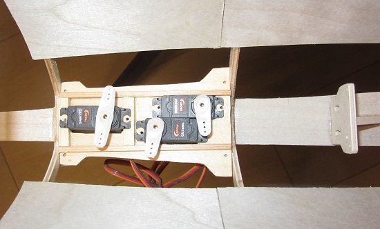

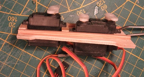

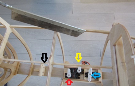

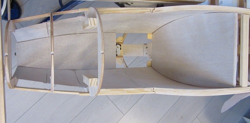

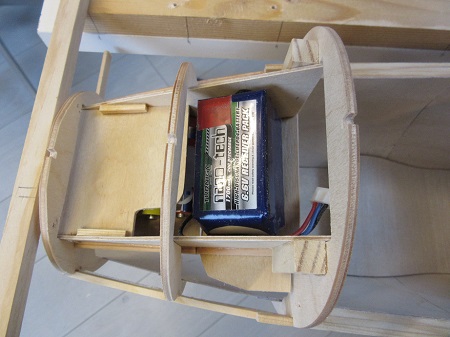

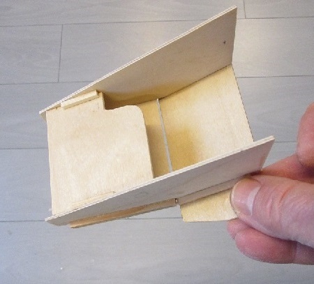

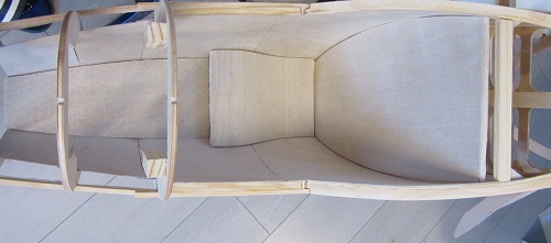

Now the servo’s. I wanted to have them in the front (good for the CG) and low, so I can make a scale interior , which I like to make... After some thinking I came up with a servo tray for the 3 fuselage servos
 The blue arrow points to the rudder servo that actuates the rudder with 2 pull-pull cables, the yellow arrow to the coupling release servo, the rod will go under the rudder servo arm to the coupling. At the red arrow is the elevator servo, that will actuate the elevator with a push-pull Bowden cable, fixed in the holder? (black arrow).
 Then I sheeted the inside with 0.6mm plywood. The front of the fuselage is now quite stable.
 Its my intention to sheet the top end of the fuselage while its still secured at the building rig to keep it in shape while putting the ply on.
Vincent (DB) |

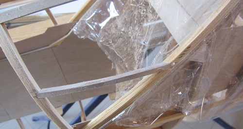

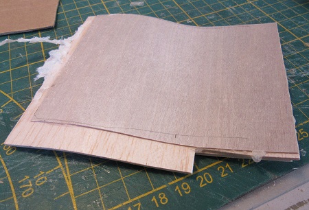

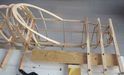

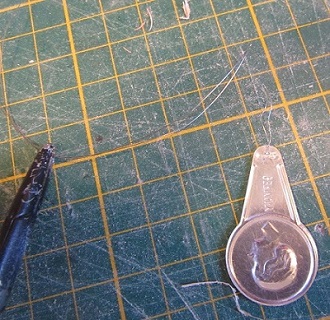

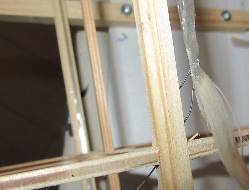

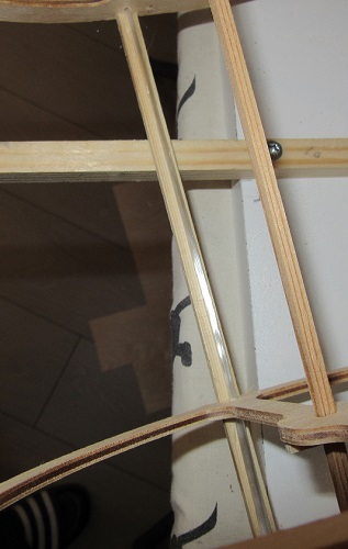

Before continuing with the cockpit, the remarks of Vincent BecanconI got me thinking about the size of the stringers in the fuselage. They have about the same (scale) size as the example, but my landings are a bit rougher than the real ones. On the other hand, a light tail boom provides much less ballast and so on. I decided to put a single glass roving with epoxy on the inside of the left and right stringer, the stiffness of glass is closer to that of wood than that of carbon. I hope it works out well.I drilled 2mm holes next to the beam and with a double folded 0.2mm steel wire I pulled the dry roving wire through the holes and impregnated it with epoxy.
 Just like the tool to pull a wire through the needle.
 After curing, the girders feel much stiffer and not much weight is added. To get the cockpit right I first fitted the pilot (borrowed from my Gull) and after some fiddling he was neatly in place . Made a backrest, seat and floor from plywood / balsa sandwich, they are fixed with screws in plywood supports,
 Enough space over the servos.

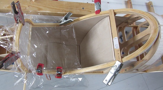

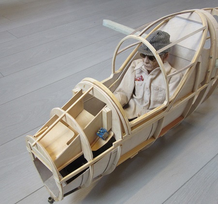

 The planned receiver battery box had a conflict with the pilot's feet, so I changed it and now the pilot has room for his feet and there is space for a 2s 1700Mah LiFe and 4s 2000Mah eneloop, they will be connected with a Schottky diode. If all goes well I can read the voltage on my transmitter.

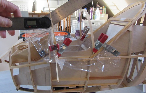

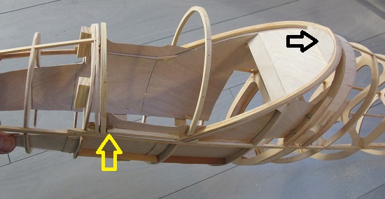

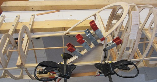

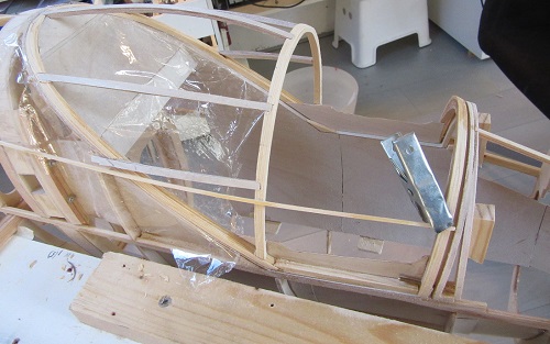

Now I could start making the cockpit canopy. In that period it was not possible to make a bubble canopy's, so this canopy is made of curved panels, nice characteristic, beautiful (thanks to Thomas for the photo).

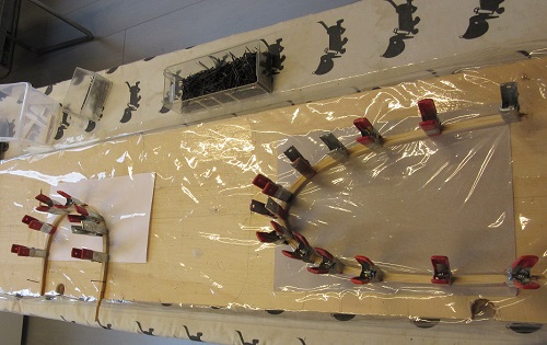

To make the supporting structure I laminated three frames.
 and glued them together on the fuselage .
 The canopy is secured at the front two pins (yellow arrow) and in the back with strong magnets, both in the hood as in the fuselage. The magnets are glued between layers 0.6 triplex (Black arrow).
 From 0.6mm plywood I laminated the longerons?
 . The canopy was quite a time consuming job, but now the frame is ready for varnishing and glazing.
Vincent (DB) |

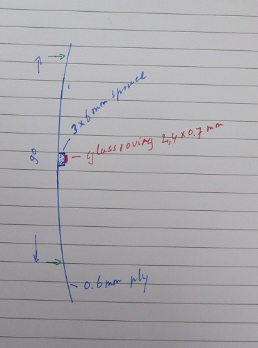

Maybe you can have a look at the fuselage,
The sketch represents about 1/4 of the side of the tailboom. The wood surface is; (from the ply taken only the innner and outer layer, parallel to the grain) 2/3 x 0.6mm x 90mm= 36mm2
the spruce stringer;
3mmx6mm= 36 mm2, total 54mm2
the glass is 2.4mmx .7mm= 1.7mm2.
I just estimate what I did, maybe you can tell me if I have to add more glass, or that it is in proportion
Regards,
Vincent(DB) |

in my opinion, sincerely, if you double the section of wooden stick… it will be quite rigid enough for… without complicated practice fiberglass.
The bending will make too the rigidity, well bonded in pressure.
Anyway, in case of a strong landing ... it will break the same

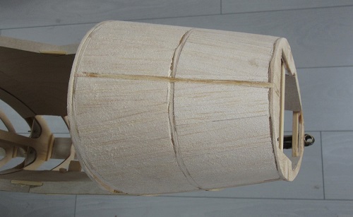

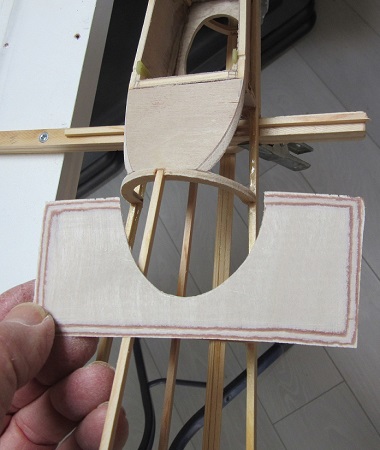

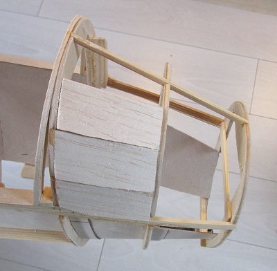

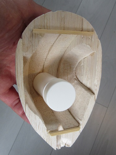

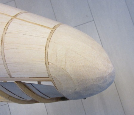

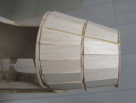

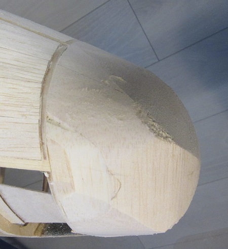

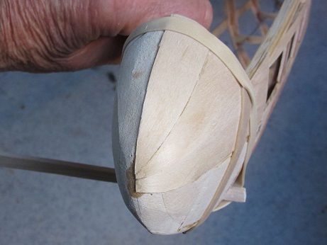

Before I was able to sheet the fuselage with ply, I had to do some preparatory work; the topside of the fuselage ahead of the cockpit will be sheeted with narrow strips (like the real one) so I had to fill it with thick balsa
 and sand it smooth
 I built the nose itself from 20mm balsa, sanded the side view first, then the top view
 and then roughly into shape
 I hollowed out the inside further (I had already partially done the gluing of the balsa together) and glued a plastic jar in it. That jar can hold 170 grams of lead.
 What I'm planning is this; when the plane is ready I put the 170gr lead in the jar, I measure how much ballast is needed and then fill the nose with lead snippets and epoxy resin. Then I have the option of removing ballast without cutting it out.
I glued in plywood reinforcements for the rear of the wing mount and 10mm balsa at the bottom of the fuselage where you grab it when you handtoss it.
 Now I could sheet the fuselage with 0.6mm plywood. Until now I glued the plywood with thick cyano, but this time I wanted to try the white glue and iron technique. This is done as follows, you smear both adhesive surfaces with PVA and let it dry. Then you put it together and press it together with a hot iron, the glue becomes soft due to the heat, and it is fixed. I had already made a few test pieces and it turned out to work.
Because the fuselage at this stage is still very flexible I put it back in the construction frame. I started with a tricky piece, first chamfer the edges with this set-up
 then smear the glue surface with PVA and let it dry
 . I could now place the piece exactly in place, fix it with clamps and iron it on
 To be sure, I later applied extra glue on the inside, you never know, this technique is new for me.....
Vincent(DB) |

Hello Vincent,
Good job and very nice, your tricky piece ! This iron technique is very interesting .
A little question : the nose will also be sheet with 0.6mm plywood ? I ask myself a lot of questions about this for the Pavelek P-2 ...
 Serge |
| Revenir en haut de page |
bocorvin Maniaco Posteur
Inscrit le: 17 Aoû 2015
Localisation: Hillegom
Âge: 79
Posté le: 30/01/2021 15:54 Sujet du message: |
Hello Serge,
Thanks for your nice comments and yes its an interesting technique, I am still a bit afraid if its strong enough.....
About the nose, I will use veneer, thats 0.6mm wood, no layers, so sanding does not show . Its on my Nemere 1/6 http://www.retroplane.net/forum/viewtopic.php?t=4645&postdays=0&postorder=asc&start=0 and also my Gull 1/4.
The restauration of the nose of a real Petrel (almost identical nose as the Gull) took a year......
Vincent (DB) |
