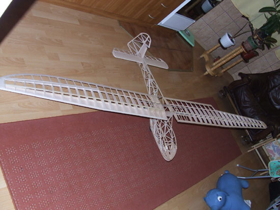

My name is Márton Csaba, i'm from Transylvania. I would like to show some pictures of my Doppi. Thanks to my friend(who gives the ideea to build this plane), for all support. Oops. I have to change the size of the pictures.... They will arrive soon...

MessagePosté le: 17/04/2007 21:28    Sujet du message: The beginning Répondre en citant
phoenix27
Inscrit le: 17 Avr 2007
MessagePosté le: 17/04/2007 21:31    Sujet du message: The wing Répondre en citant
....step by step... slowly, but surely Very Happy

MessagePosté le: 17/04/2007 21:36    Sujet du message: And the plane 1st pic Répondre en citant
phoenix27
MessagePosté le: 17/04/2007 21:38    Sujet du message: 2nd pict Répondre en citant
...with a little help from my friend Very Happy
