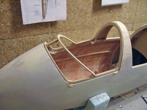

Moving on now to the cockpit canopies. It looks as though two of my Skylark 4 canopies will do the job Very Happy

Still working on the canopies... Zzz

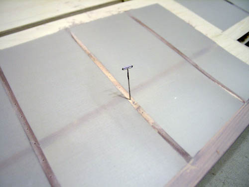

But how to stick the 'Tex to the underside of the ribs? This is what I do:
1: Prick holes in the fabric with a blunt pin
2: Fill holes with ultra-thin CA (Wipe off excess with a cloth)
3: Finish off with 'Tex rib tapes
cw
MessagePosté le: 20/03/2011 11:16    Sujet du message: Répondre en citant
thanks for the trick, useful on very curved intrados ribs Wink
