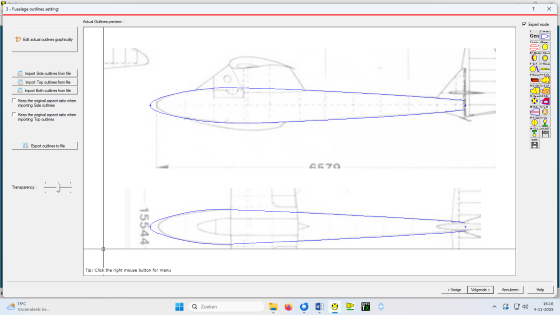

I started drawing the fuselage, with Devfus, based on the existing drawings. I couldn't get the nose to match the photos. In the photos, the nose looked more pointed than in the drawing, so I decided to make the nose a little more pointed, which also meant that the e-drive with spinner would fit. A little bit of cheeting is allowed now and then.....
A three-dimensional image of the fuselage gives a good impression and, no, it's not a submarine! The internal reinforcements for the pylon, battery and removable cockpit can also be seen here.
