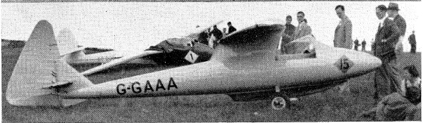

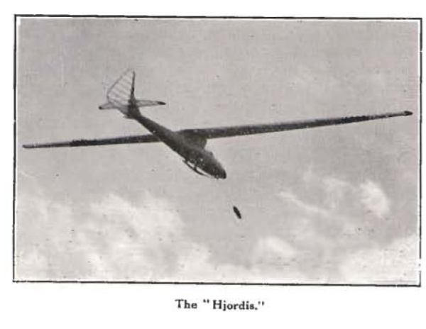

First, a some notes about the real Hjordis, a prototype, only one built. In England, the development of gliders was less spectacular than in Germany. Due to the peace treaty after WW1, a great deal of energy was put into the development of gliders in Germany. In England, this changed in the 1930s, resulting in this more or less successful attempt. Only one Hjordis was built, and it had its shortcomings. For the full story, see the link below.
https://all-aero.com/2025/04/11/slingsby-hjordis/
The designer, Buxton, sought optimal performance and drew an extremely slender round fuselage with a pylon on which the wing was mounted. The pilot just about fits (not 😊) and the cockpit canopy fitted nicely to the pylon. The wing was beautifully slender, with a chord of 117 cm at the root tapering to 30.5 cm at the tip, with a wingspan of 1555 cm and a aspect ratio of 21. However, it had a thick and curved profile, from Gottingen 652 at the root to RAF 32 at the tip. It was a fairly revolutionary aircraft for its time. To be able to reduce speed, Buxton had come up with the idea of making the rudder double, which could then be folded out. There were other gliders (the Elefant) that tried this, but unfortunately it did not work. As a result, it had no spoilers or anything like that, which in hindsight was a great loss. I am definitely going to install spoilers.
Another problem was the very small cockpit. The fuselage was 660 mm in diameter and the pilot, Phillip Wills, suffered from cramps and splitting headaches in that claustrophobic and hot cockpit. By scutting out a few “chunks” out of the fuselage at shoulder height, he was able to sit a little better and the ventilation was also improved
I haven't read anything about getting cold shoulders... Martin Simons' book tells the whole story beautifully.

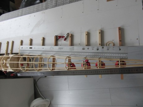

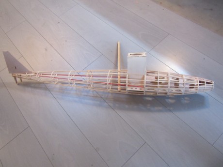

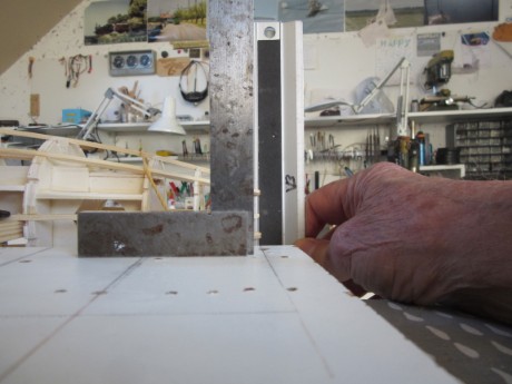

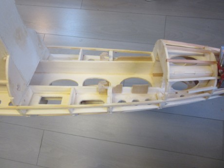

I went on with the fuselage, the two stringers on sides are on the construction level so on the 10 x 10 mm slats. With these stringers in place and the center of the formers on the centerline, I can secure the formers with clamps. I can check the outside nicely
I had to leave out the two front 10 x10 due to lack of space, but with a engeneer square on the building board I could straighten them out nicely

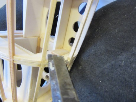

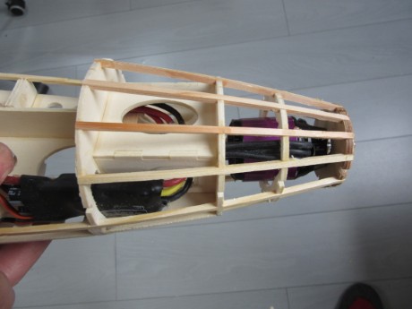

Next the cut-through formers, with a chisel I removed the temporary battens, and then I was able to detach the detachable fuselage pieces.
Of course they were still glued here and there. Some minor damage on a former

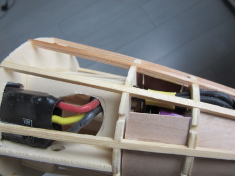

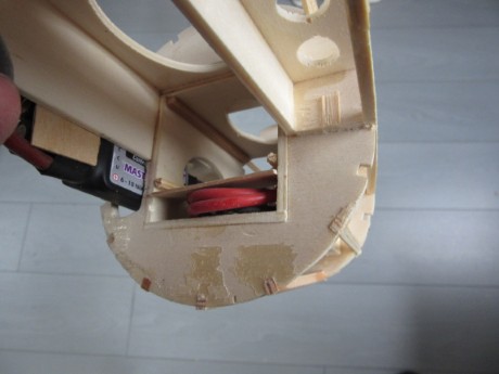

The motor fitted nicely, the leads and the controller were a puzzle. I could just put the controller on the side, I want to keep the battery box free, so that I can get the cg right with the battery. Of course everything has to remain detachable
I made two dowel pins and lugs for the back part of the detacheble fuselage piece
To make the nose firm, I also glued 0.6mm plywood on the inside. That will then form a nice sturdy construction with the plywood on the outside.
With the necessary fidgeting I was able to glue the fin and trusses for the skeg in the tail.
The fuselage is now making good progress and weighs about 400 gr. It still looks like a submarine...

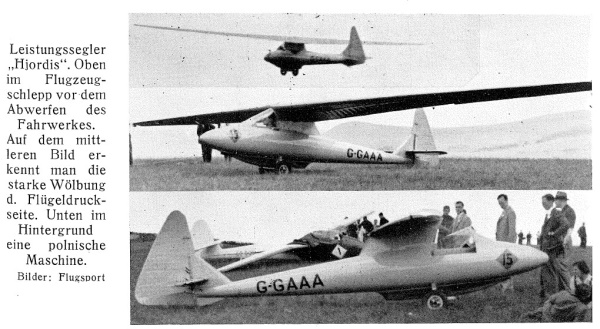

Hallo Vinc,
ich habe einige Bilder gefunden:
Thomas
bocorvin
Inscrit le: 17 Aoû 2015
Localisation: Hillegom
Âge: 80 Vierge
MessagePosté le: 20/12/2025 17:04    Sujet du message: Répondre en citant
Danke Thomas,
Ich bin erstaunt Very Happy. Schone bilder, da kann Ich doch die Cockpit Haube gut machen! [clap] [clap]
Vincent (DB)
ThomasF
Inscrit le: 16 Jan 2010
Âge: 67 Taureau
MessagePosté le: 20/12/2025 18:28    Sujet du message: Répondre en citant
größer geht nicht

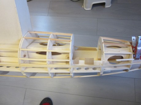

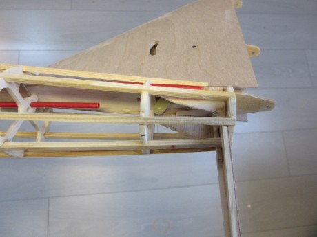

To make the skeg, I had to sheet the fuselage, but I also had to make the control rods. With the the control rods, I couldn’t replace the fuselage on the building jig…… So first the sheeting the bottom, then the skeg and the control cables later.
So first, the skeg, had to take some pieces of the frames away
The advantage of building on a horizontal jig is that the fuselage can be put on and taken off. To sheet the tail (the nose is already dimensionally stable due to its internal structure), I slid the fuselage back onto the jig. The fuselage rests stable there, and now I can sheet the bottom. After fitting a piece of 0.6mm plywood to size, I scarfed the edges
The rear end of the tail was quite narrow, I bent the rear pieces under boiling water and let them dry rolled up, put a rubber band around it and let it dry
How far you can bend it; see https://youtu.be/KoZUbuMlBck.
I glued the plywood with PVA and because the fuselage is open at the top I could clamp it to the stringers
Skeg construction
Then the servos were installed and the Bowden control rods aligned checking if everything moved well.

Bonjour a tous,
Now I had to sheet the upper half. I found that quite difficult, especially applying pressure on the glue. Finally, with a few drops of cyano, I glued 3 X 3 slats onto a prepared panel
I spread PVA on the stringers and frames, except for the horizontal stringer where the bottom panel was already glued to. There I put cyano on the edge of the panel. This way I could press it nicely in place
until the cyano was set. It then looks like this
I cut off the slats later. I did the entire fuselage in the same way.
Unfortunately, I couldn't get it super smooth, that had to be sanded, I wasn't very happy with that. Fortunately, all the wood is painted, not clear varnished, that gives me a lot more freedom, but still....
Fortunately, it does feel light.
Then back to the neck and cockpit. The Hjordis drawings are actually sketches. By the way, a lot of details were solved in the workshop of Slingsby.
The full-size wing was much thicker than the one on the model. Fortunately, the profile was chosen (see Merijn's post). After some initial thinking, I managed to sketch the cockpit and the wing neck. Finally, I based my work on the angle of the front of the cockpit, which I felt was crucial for the appearance.
Then it turned out the neck was still too long; I still needed to trim off another 15mm, grumble. Cut it off, scarfed and glued it with thickened epoxy. The angle of the wing to the centerline, is 9 degrees, which seemed like a good compromise to me.
Now I could create the transition from the cockpit canopy to the fuselage and the wing with a laminated spar (which will be discussed later).
This finished, I also could make the fairing around the neck.
An extra frame some and slats for the streamling of the neck.
This is how it looks now.
A try out with a piece of cardboard instead of the "glass" to check if all is aligned.
The streamlining was unusual for its time!
The fuselage now weighs 625 grams, excluding the three servos.
Vincent (DB)

The cockpit, or rather the canopy, is the “face” of the model. Unfortunately, I overlooked something while taking the measurements. I had already rebuilt the canopy frame twice, but it still wasn't quite right. The problem was that the canopy is slightly tapered, and there are no actual drawings of it. It was also a bit too short, and I had also lengthened the nose a bit, and I didn't like the result. It would be better to remake it, and that's what I'm going to do.
I took another good look at the photo’s and discovered that the cockpit opening was rectangular and not tapered (I had blindly used the existing stringers, which turned out to be incorrect).
I adjusted the opening, and now the pointed streamlined body became larger and more forward, which also made the nose a bit shorter.
The "shoulder holes" also needed to be a bit larger.
A makeshift engine shaft was used to see if the spinner would fit.
Old;
New;
And the real thing;
Glad I changed it.

A wonderful story about the Hjordis, it was written in the Sailplane and Glider.
Thomas provided me the scans of this magazine and I found this;
In te middle of the page he writes that he preferred a steering wheel instead of a stick, to prevent a broken leg when his wing broke of (when flying in clouds) and the cable of the aileron actuation (still attached to the ripped off wing) would ram the steering stick in his his leg and prevent him bailing out.!
Opinions change!
