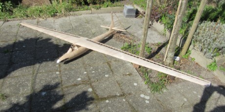

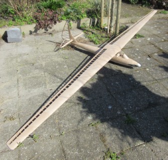

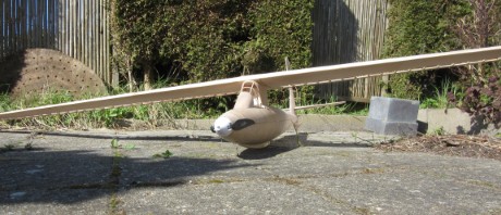

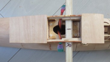

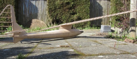

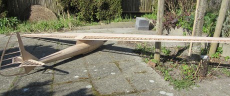

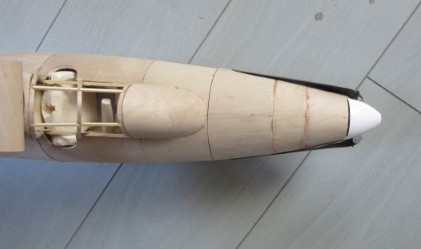

The Hjordis is now making good progress. Spent an afternoon preparing all the actuation rods . I sheeted the wing center section and made a hatch in it, to get to the connections. I also made a bust for the pilot, because of the lipo it couldn't fit a complete pilot.
The clothes and the head will come later. It's sunny, so I went outside to take pictures. I put the motor in so I could mount the prop properly. Luckily the prop blades closed smooth to the fuselage! That made me happy.
I thought the model looked quite like the real thing, The prop will sprayed the same colour as the fuselage, hopefully they will stand out less.
Now it has to be sanded and finished.
Vincent (DB)
Nouveau messagePosté le: 18/03/2026 16:58    Sujet du message: Répondre en citant
Hi Vincent,
Your driver’s got broad shoulders… stronger man Laughing
I can’t wait to see how you finish it off !

Nouveau messagePosté le: 18/03/2026 18:07    Sujet du message: Répondre en citant
Hi Sebastian,
The pilot hasn't got broad shoulders, he will get a big head and the plane is very narrow!
He can just turn his head in the canopy MDR . The openings for his shoulders were cut out later, he got cramp!
Amicalement,
Vincent (DB)
