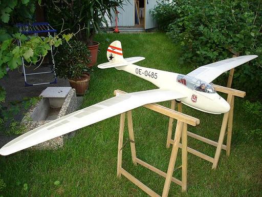

Good evening...
It´s done... Very Happy
I´m very satisfied with my wings - it`s the first time that I´ve painted a plane. The quality of the rudder finish is not so good but for me it´s OK. Here is a detail of the wings surface...
I see - some of you did help me with good wishes... Wink

MessagePosté le: 21/05/2007 22:29    Sujet du message: Répondre en citant
Well done, nice job !
It seems that the secret is to paint imediatly after the tape masking. Not leaving the tape many days in order to prevent any "leaks" under masking.
Sylvain.

MessagePosté le: 23/05/2007 18:08    Sujet du message: Répondre en citant
Hello Sylvain,
...I think that´s it - after the masking I`ve painted along the tape with a very "dry" brush - I think it´s important to use not too much colour for this first painting:
I pulled of the masking tape about 20 minutes after the second painting. But at the end I think that practice is the best help for a good result. And so I think about new projects to get this practice... Wink

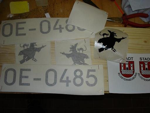

...the decals are also ready... Very Happy
The witch and the identification are perfekt - with the red sign I´m not so happy.
Walter

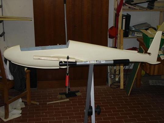

Nouveau messagePosté le: 01/06/2007 18:14    Sujet du message: Répondre en citant
...my fuselage ist finished. All in all im satisfied for this first all wooden Oldtimer...but...at the retroplane meeting I will not allow anyone to come nearer than 2m to my MG19... Embarassed Laughing
For me the cabin was the most difficult part. Maybe I try to make a cabin with brass tubes after this season.

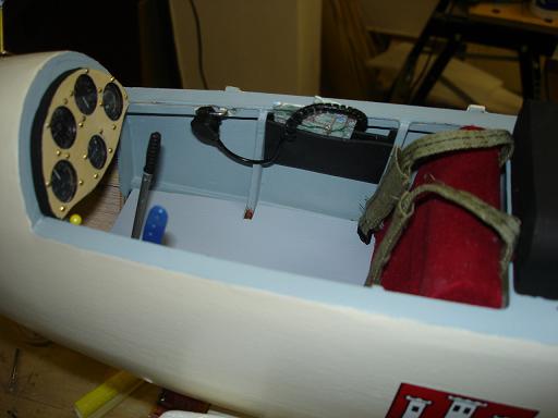

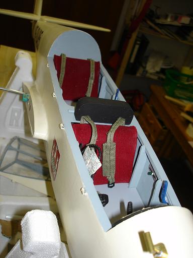

Well - the last weekend I spent some Time to realize the cockpit. At first I had to make the seats:
My wife said, that the winered is perfect to the colour of my MG19... Wink
Walter
Inscrit le: 05 Nov 2006
Nouveau messagePosté le: 04/06/2007 19:08    Sujet du message: Répondre en citant
...and today I completed the cockpit. Most of the parts are made by myself. Everything can be removed - so it`s no problem to reach the electronic parts...
